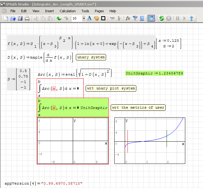

#1 Posted: 1/28/2019 4:22:38 PM
Integrate Arc Length UNARY.sm (10.12 KiB) downloaded 1163 time(s).

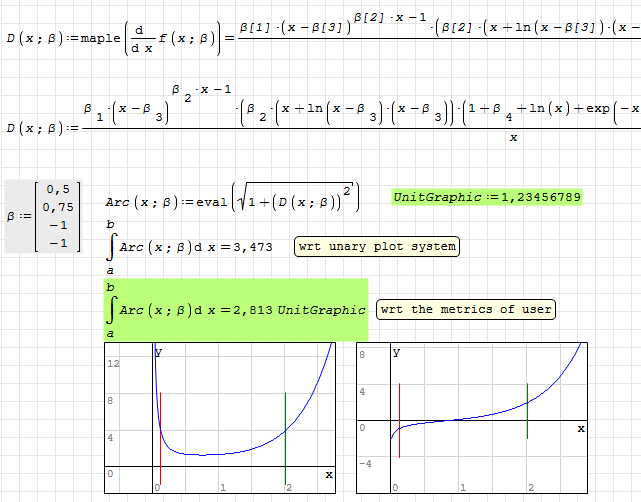

#3 Posted: 2/3/2019 12:25:36 PM
1,443 likes in 2,935 posts.
I use the last beta version, but I get a error 'x-not defined'
It is probably because MapleTools returns β[#] instead of el(β,#)

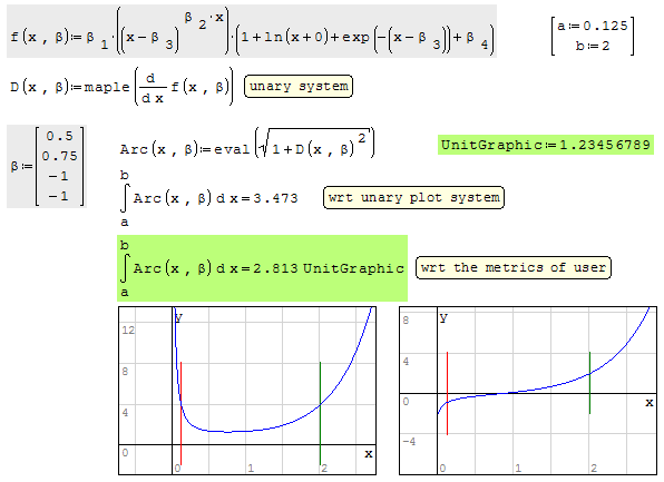

#5 Posted: 2/3/2019 4:45:38 PM
1,555 likes in 1,867 posts.
"It is probably because MapleTools returns β[#] instead of el(β,#)"
MapleTools updated. Issue fixed.

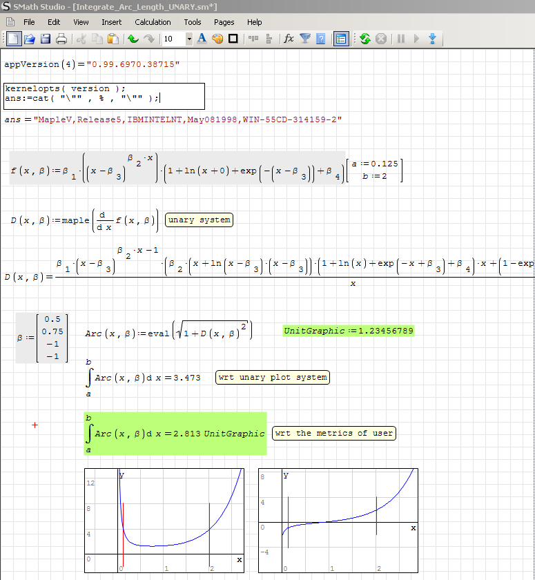

#6 Posted: 2/3/2019 10:05:25 PM
in which version did you prepare this example?
... from Smath 6179.
As Davide points out, your latest freaks Maple !
