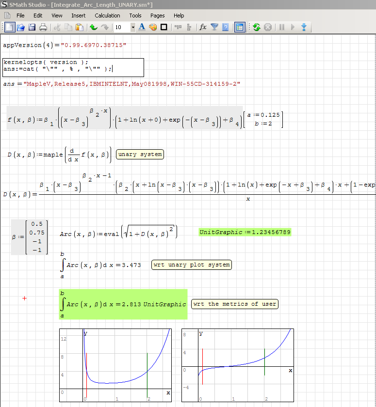

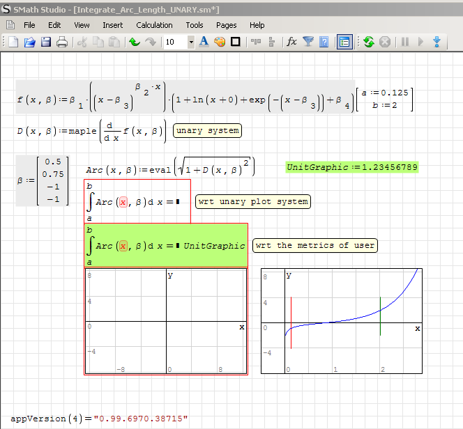

Hi Jean,
in which version did you prepare this example?
I use the last beta version, but I get a error 'x-not defined'

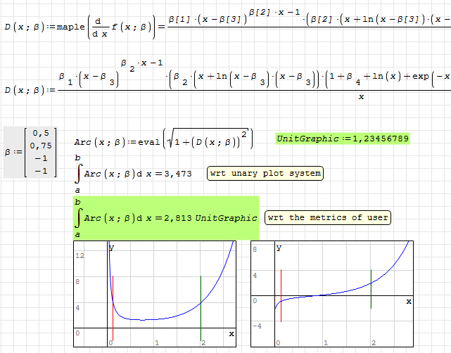

It is probably because MapleTools returns β[#] instead of el(β,#)

"It is probably because MapleTools returns β[#] instead of el(β,#)"
MapleTools updated. Issue fixed.
