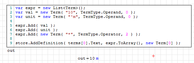

#3 Posted: 3/22/2017 1:04:37 PM
1403 likes in 1708 posts.
One possible way.
var expr = new List<Term>();
var val = new Term( "10", TermType.Operand, 0 );
var unit = new Term( "'m", TermType.Operand, 0 );
expr.Add( val );
expr.Add( unit );
expr.Add( new Term( "*", TermType.Operator, 2 ) );
gregi 3/22/2017 2:30:00 PM
#4 Posted: 3/22/2017 2:31:07 PM
gregi
gregi
1 likes in 5 posts.
Thank you uni! Your solution is exactly what I needed
