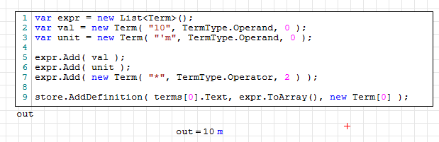

One possible way.
var expr = new List<Term>();
var val = new Term( "10", TermType.Operand, 0 );
var unit = new Term( "'m", TermType.Operand, 0 );
expr.Add( val );
expr.Add( unit );
expr.Add( new Term( "*", TermType.Operator, 2 ) );

Thank you uni! Your solution is exactly what I needed
