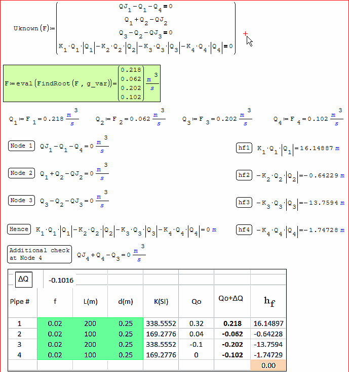

Examples of a problem solved in SS and Excel are attached.
The results are tallying.
Pipe Network Ex3.1.sm (417.66 KiB) downloaded 1684 time(s).
Pipe Network by Solver Ex3.xlsx (301.19 KiB) downloaded 1218 time(s).

IMHO, in this case the EXCEL solution is "cleaner".
EXCEL shines when you need to process simple formulae applicable to many rows of data... Which we do have in this case.
#3 Posted: 4/14/2016 10:47:43 AM
The problem is not to insist to expand symbolic. If you were scared of that one,
you have seen nothing compared to > 12 pages wide expansion. Before expanding,
hover Unknown(F) and see if it is of any profitable use.

#4 Posted: 4/14/2016 10:49:59 AM
... forgot to attach WS.
Pipe Network.sm (194.18 KiB) downloaded 1476 time(s).
