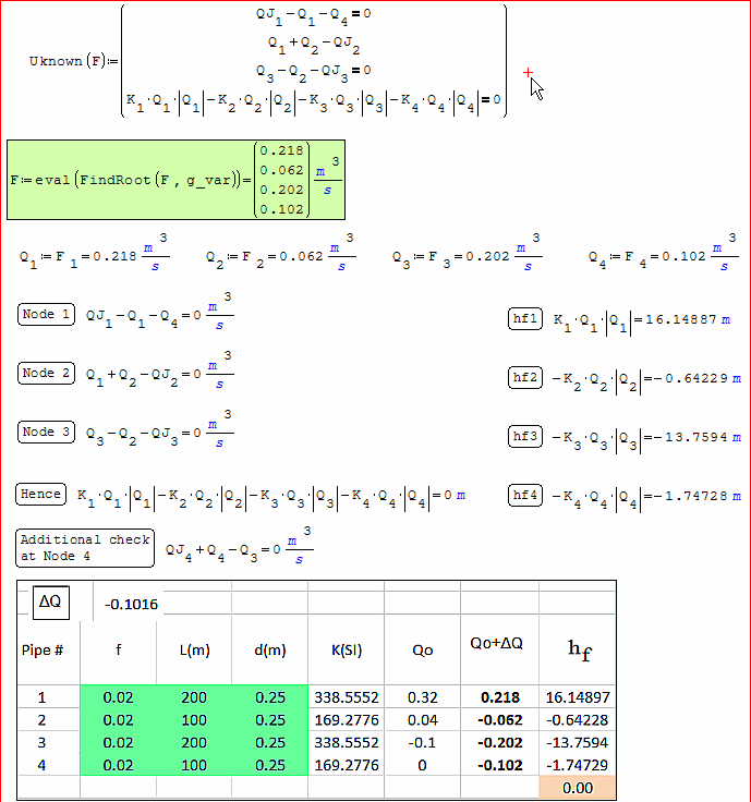

Examples of a problem solved in SS and Excel are attached.
The results are tallying.

IMHO, in this case the EXCEL solution is "cleaner".
EXCEL shines when you need to process simple formulae applicable to many rows of data... Which we do have in this case.

The problem is not to insist to expand symbolic. If you were scared of that one,
you have seen nothing compared to > 12 pages wide expansion. Before expanding,
hover Unknown(F) and see if it is of any profitable use.

Pipe Network.sm (194,18 КиБ) скачан 1478 раз(а).
