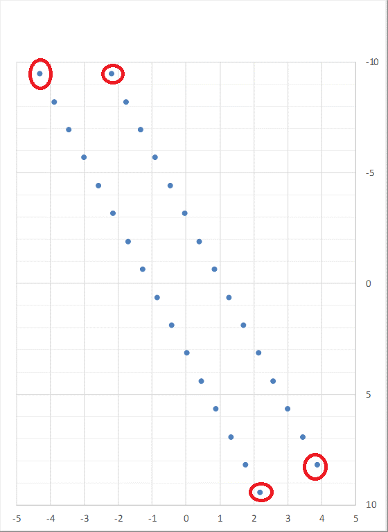

Hi All,
Need some conceptual ideas on how to find corners of a grid of points represented by XY coordinates. Any input is appreciated. Thanks!

Hi Ioan, thats a good start :-). My aplogies for not wording my request more clearly. I need to identify following points programmatically.
For any generic array of XY data there are (in my case always 4) corner points that I need to find and identify.
The issue that I faced is that for some of 4 corners the coordinates are not always MIN/MAX of the entire array... I have tried setting up a function based on MIN/MAX that does not work if a corner point is not defined by XY extremity value.
Really what i need is the concept, I can and will do the function myself (since I do not want to take much of anyones time).

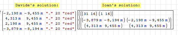

@Davide,
Very interesting your solution.
But in fact your solution gives almost the same results as mine's - one position exception:
Now, it's Alex's turn to use or to unvalidate.
Best Regards,
Ioan
