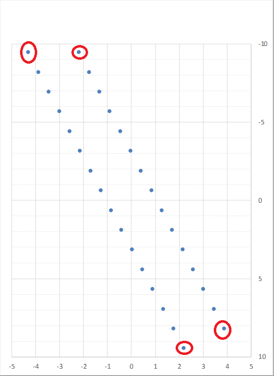

Hi All,
Need some conceptual ideas on how to find corners of a grid of points represented by XY coordinates. Any input is appreciated. Thanks!

Hi Ioan, thats a good start :-). My aplogies for not wording my request more clearly. I need to identify following points programmatically.
For any generic array of XY data there are (in my case always 4) corner points that I need to find and identify.
The issue that I faced is that for some of 4 corners the coordinates are not always MIN/MAX of the entire array... I have tried setting up a function based on MIN/MAX that does not work if a corner point is not defined by XY extremity value.
Really what i need is the concept, I can and will do the function myself (since I do not want to take much of anyones time).

Thank you very much guys, both codes identify the points correctly (and point out that my plot is not correct actually). You have just identified the most heavily loaded piles in a pile group, something that till now I always had to do by hand when automating per-pile demand calculation.
Ioan, your code will need a small tweak to identify points 16 & 17 instead of just 16.
Davide, it will take me sometime to digest the formula you are using; it seems to be quite general and applicable to any? point cloud, which is great!

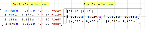

@Davide,
Very interesting your solution.
But in fact your solution gives almost the same results as mine's - one position exception:
Now, it's Alex's turn to use or to unvalidate.
Best Regards,
Ioan
