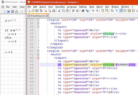

WroteWhy does this return false (see image below)?
Is there anything I can do to correctly evaluate this?
Without the file it can be the same as gambling. My best guess is that when copying and pasting text many times SMath takes the unicode character instead of the simpler ASCII character, as in the attached file.
UnicodeIssue.sm (2.68 KiB) downloaded 1413 time(s).
Conclusion: do not copy and paste quoted strings in SMath, but rather write them.

#10 Posted: 12/6/2023 2:07:12 AM
Note to future self when I don't update this and I have this problem again in 3 years...
1.) Expand the collapsed matrix in the SMath file.
2.) Copy the "-" from inside the matrix.
3.) Paste (replace) this into your functions.
Voila
Voila
