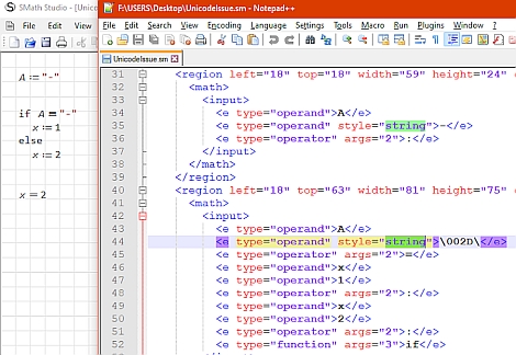

Without the file it can be the same as gambling. My best guess is that when copying and pasting text many times SMath takes the unicode character instead of the simpler ASCII character, as in the attached file.
UnicodeIssue.sm (2,68 КиБ) скачан 1414 раз(а).
Conclusion: do not copy and paste quoted strings in SMath, but rather write them.

Note to future self when I don't update this and I have this problem again in 3 years...
1.) Expand the collapsed matrix in the SMath file.
2.) Copy the "-" from inside the matrix.
3.) Paste (replace) this into your functions.
