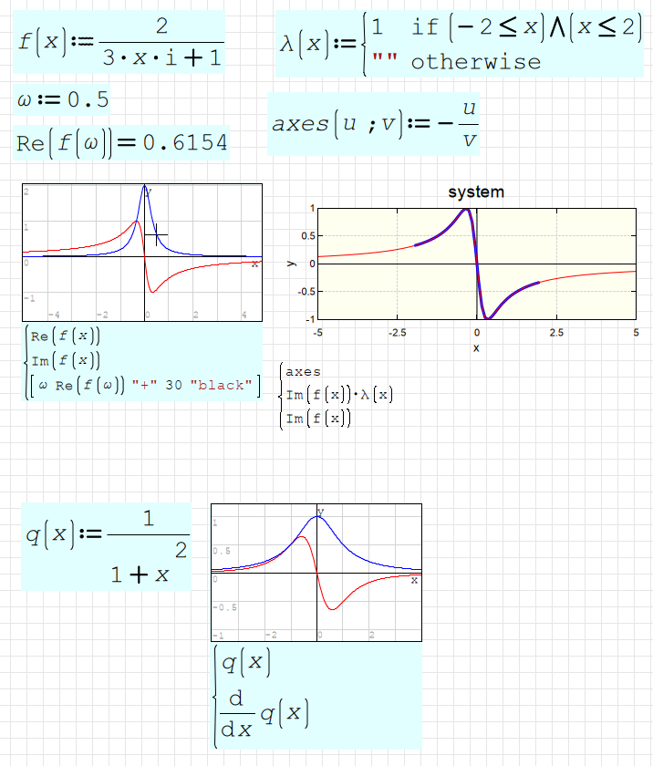

#1 Posted: 2/12/2024 8:49:16 PM
Valery Ochkov
Valery Ochkov
66 likes in 697 posts.
#2 Posted: 2/12/2024 10:44:45 PM
598 likes in 1,380 posts.

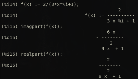

Natively, I don't know how it can be done.
Possibly you can't because smath symbolic engine is inferior.
Maxima can solve it. I assume maxima plugin can solve too in smath.
Maple plugin couldn't solve, maybe there is a trick I don't know.

#5 Posted: 2/13/2024 3:58:14 AM
Maybe, Re() and Im() are worth adding to MaximaTakeover? Yet wrapping in Maxima() does the trick for now.
ReIm.sm (3.95 KiB) downloaded 1480 time(s).
I assumed so!
