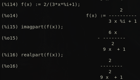

Natively, I don't know how it can be done.
Possibly you can't because smath symbolic engine is inferior.
Maxima can solve it. I assume maxima plugin can solve too in smath.
Maple plugin couldn't solve, maybe there is a trick I don't know.

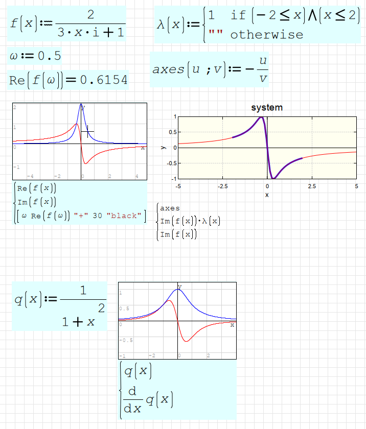

As suggested ... remembering Imaginary is the Derivative
Worksheet104.sm (9,66 КиБ) скачан 1531 раз(а). ... Please, let me know if working ... Jean

Maybe, Re() and Im() are worth adding to MaximaTakeover? Yet wrapping in Maxima() does the trick for now.
ReIm.sm (3,95 КиБ) скачан 1480 раз(а).
