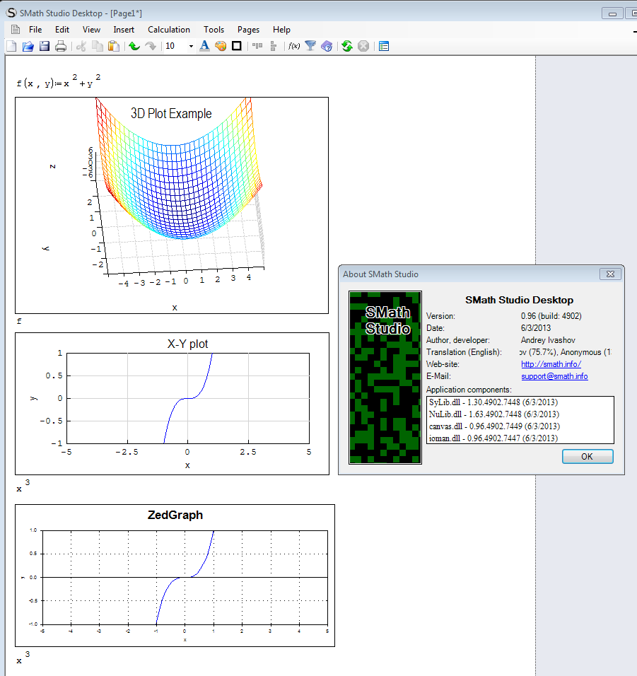

You can't use the old plug-ins with the regions. Therefore, a simple copy of the old version will fail. Do not use this way for old such plugins. As I said, they need to be recompiled with a small addition. New plugins can be copied. Do not use the plug-ins from my ftp, they are all old. Plugin Manager is not completed yet, Andrey is working on it. In any case, if there is a problem, try to remove all user's plugins manually from ..\SMath\plugins and ..\AppData\[username]\SMath\extensions\plugins, then install them from the gallery.
As for me, everything works fine:
[albumimg]203[/albumimg] [albumimg]206[/albumimg]

For me as well
There is still already mentioned problem of saving graphs and the graphs settings. Am I right about it?
[albumimg]207[/albumimg]
#5 Posted: 6/8/2013 6:30:11 AM
1403 likes in 1708 posts.
We are still thinking about it. ZedGraph has too many parameters and we have not come up with a simple way to save them to a file. It should be transparent to the programmer. In addition, we are thinking about how to make a dynamic display properties of the graph depending on the experience level (convenience).

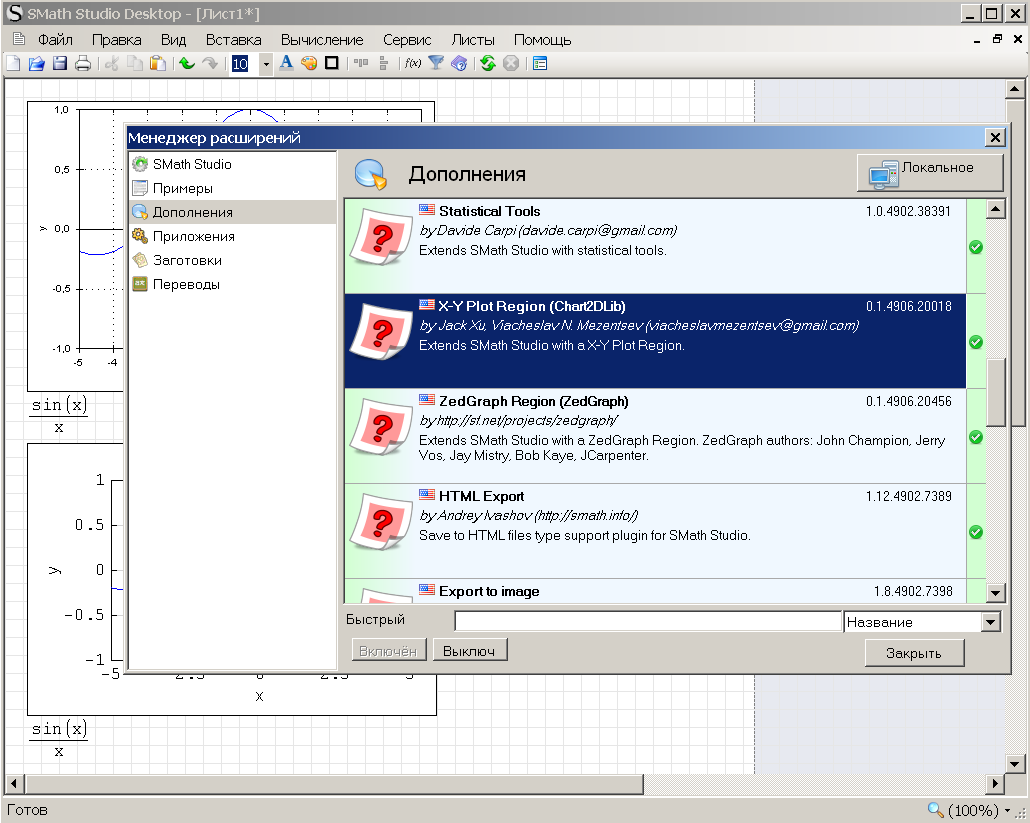

DataExchange Plugin is installed but it is not working for me. See attached message
Correct GUID must be set for every plugin in Assembly Info to make it possible to work with Extensions Manager.
