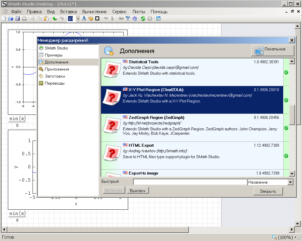

I observed two cases, where the installation of a plugin via extension manager failed. The files were downloaded and placed in the extensions/plugins directory, but then failed to load, throwing an error message.
This may well happen and the extension manager is perhaps not to blame for that.
But here is where the bug comes. The extension manager does not list the installed files under local storage, thus there is no possibility to deactivate/delete them. However, the files are still there and cause error messages on each program startup. The only way to get rid of the problem is to manually remove the files from the extension dir.

I had no problem installing the recent plugins from Online Galery made by uni and w3b5urf3r , provided all the previous user plugins deleted from the installation folder. However, there are now two folders where the plugins resides with the SMath Desktop (I think) - Installation folder ..\SMath\plugins - users folder *WIn7* ..\AppData\Roaming\SMath\extensions\plugins . I am not sure what is happening with the "SMath plugins" (made by Martin) and how that can be "portable". By the way, I mentioned this on Ubuntu that the recent build does not work. Closing the Extension manager will close SMath. I do not know if this has anything with the behavior Martin mentioned.
Not quite sure yet how is all of this going to work. Manual copying or of plugins may cause the problems. In the recent nightbuld it is said that the external plugins must be deleted and used only via Extension manager. I managed once to crash SMath by copying a plugin into the installation folder, but some other plugins cause no problems by manual copying into the plugins folder (both of them).
I think this needs to be clarified a bit.
#3 Опубликовано: 08.06.2013 06:06:21
You can't use the old plug-ins with the regions. Therefore, a simple copy of the old version will fail. Do not use this way for old such plugins. As I said, they need to be recompiled with a small addition. New plugins can be copied. Do not use the plug-ins from my ftp, they are all old. Plugin Manager is not completed yet, Andrey is working on it. In any case, if there is a problem, try to remove all user's plugins manually from ..\SMath\plugins and ..\AppData\[username]\SMath\extensions\plugins, then install them from the gallery.

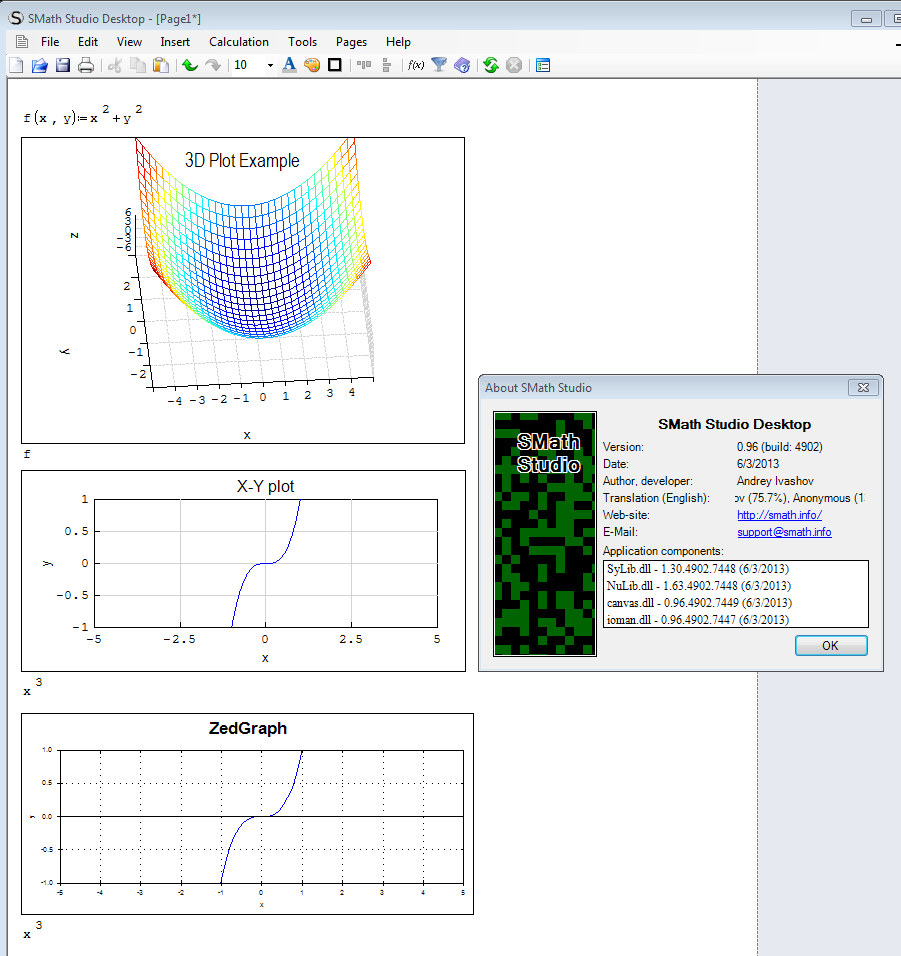

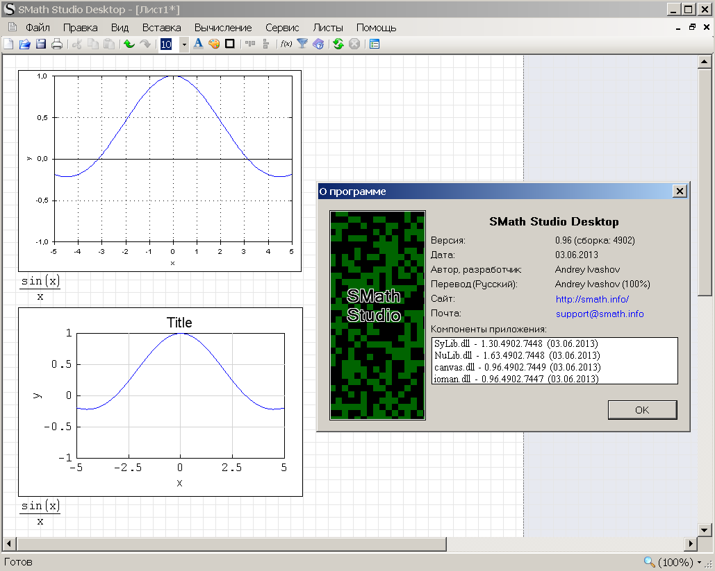

As for me, everything works fine:
[albumimg]203[/albumimg] [albumimg]206[/albumimg]
