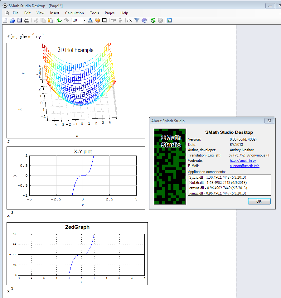

You can't use the old plug-ins with the regions. Therefore, a simple copy of the old version will fail. Do not use this way for old such plugins. As I said, they need to be recompiled with a small addition. New plugins can be copied. Do not use the plug-ins from my ftp, they are all old. Plugin Manager is not completed yet, Andrey is working on it. In any case, if there is a problem, try to remove all user's plugins manually from ..\SMath\plugins and ..\AppData\[username]\SMath\extensions\plugins, then install them from the gallery.
As for me, everything works fine:
[albumimg]203[/albumimg] [albumimg]206[/albumimg]

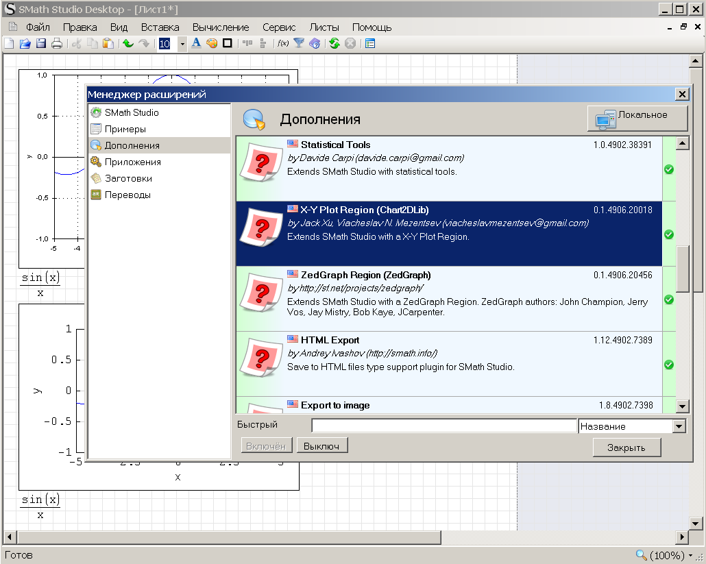

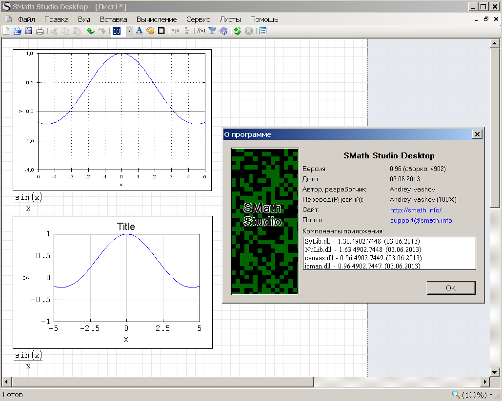

#4 Опубликовано: 08.06.2013 06:21:40
For me as well
There is still already mentioned problem of saving graphs and the graphs settings. Am I right about it?
[albumimg]207[/albumimg]
#5 Опубликовано: 08.06.2013 06:30:11
We are still thinking about it. ZedGraph has too many parameters and we have not come up with a simple way to save them to a file. It should be transparent to the programmer. In addition, we are thinking about how to make a dynamic display properties of the graph depending on the experience level (convenience).
