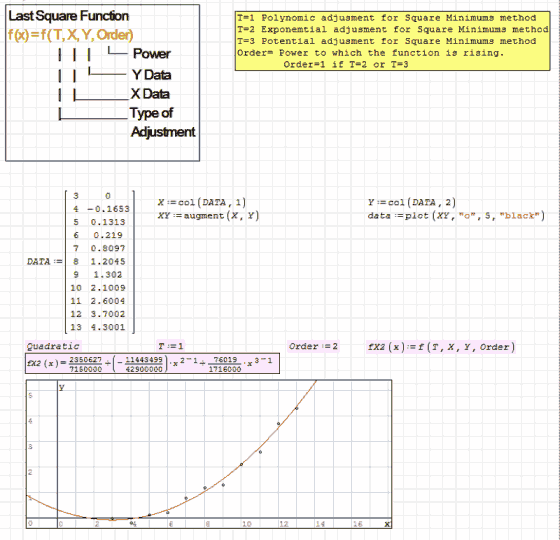

#1 Posted: 4/26/2019 12:06:13 AM
Another example of curve fitting by the least squares method
with option to select the power of the polynomial, or
select the adjustment of the curve to exponential or potential.
Ajust_by_Last_Square_Selection_Jean.sm (56.61 KiB) downloaded 1357 time(s).
Carlos
Carlos
5 users liked this post
frapuano 4/26/2019 4:12:00 AM, sergio 4/26/2019 5:33:00 AM, NDTM Amarasekera 4/26/2019 7:20:00 AM, Arie 4/26/2019 9:38:00 AM, Davide Carpi 4/28/2019 5:56:00 AM
