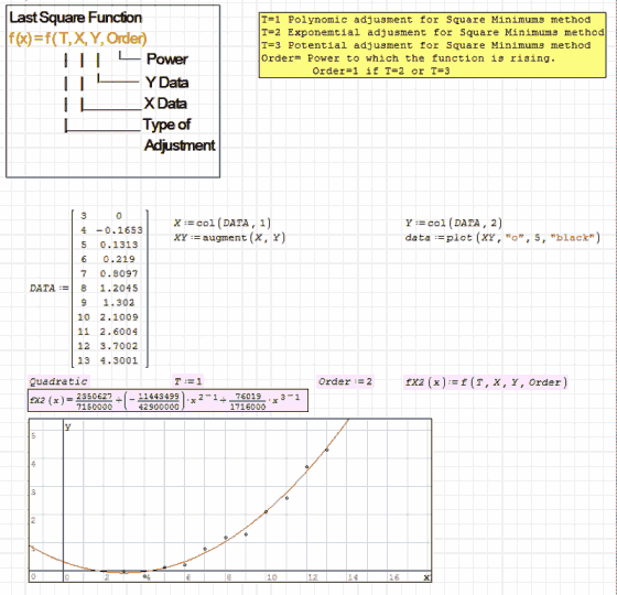

Another example of curve fitting by the least squares method
with option to select the power of the polynomial, or
select the adjustment of the curve to exponential or potential.

Hola Carlos !
Couldn't open the attached SS 7030 work sheet.
It happened another time from maybe Alvaro ?
Seemingly caused by 2 of your modules not activated.
My SS 6179 does not closed those two particular modules.
However, I have recognized the flat parabola data set.
I'm sure your proposal will have more applications.
Data sets with flat region best fit by model function,
like this one from al_nleqsolve, always assumed noisy.
Two flat parabolas attached
Thanks... Cheers ... Jean
Genfit [Algo Minimize(Cholesky_3 NonLinear)].sm (37,14 КиБ) скачан 1077 раз(а).
Genfit al_ nleqsolve [Edu Model FLAT Parabola].sm (30,24 КиБ) скачан 1085 раз(а).
