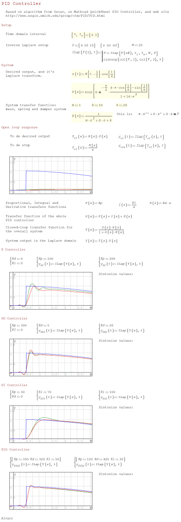

#1 Posted: 12/8/2018 1:08:50 AM
pid_controler.sm (56.12 KiB) downloaded 1300 time(s).
Based on the numerical laplace inverse from Oscar.
#2 Posted: 12/9/2018 2:55:54 AM
Laplace stuff is purely Edu.
Isn't. With the attached SMath file you can make the performance optimization of ABB, Schneider and others PID controllers according with their described procedures, as is indicated in this few examples from a very big collection of PID tunning procedures from the modern control industry

#3 Posted: 12/11/2018 10:32:56 PM
Read first: EXAMPLE_0 ...
suite if you think you have interest in that kind of stuff.
