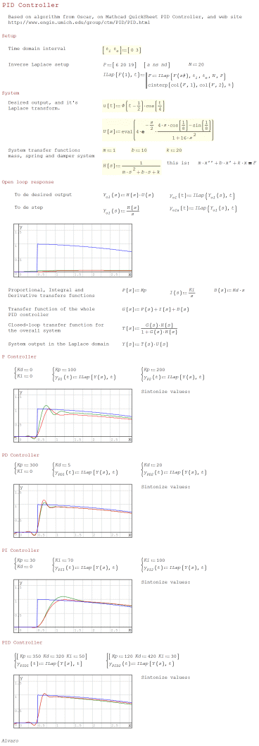

pid_controler.sm (56,12 КиБ) скачан 1300 раз(а).
Based on the numerical laplace inverse from Oscar.
Laplace stuff is purely Edu.
Isn't. With the attached SMath file you can make the performance optimization of ABB, Schneider and others PID controllers according with their described procedures, as is indicated in this few examples from a very big collection of PID tunning procedures from the modern control industry
ABB:
- Tuning loop: control performance and diagnostics :
https://library.e.abb.com/public/2925fa1164ff90a185256f9b005aad3f/LPM_Paper_Final%20EN.pdf
Schneider:
- PID Optimization – Altivar Process : https://www.schneider-electric.com/resources/sites/SCHNEIDER_ELECTRIC/content/live/FAQS/355000/FA355451/en_US/Application%20Note%2051%20-%20PID%20tuning.pdf
