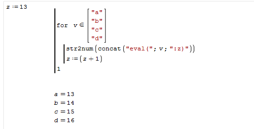

Is it possible to procedurally define variables from strings?
I want to load data to a lot of sets of variables with names following a pattern preferably without doing that manually.
Is there a better way than:
example.sm (4.39 KiB) downloaded 1348 time(s).?

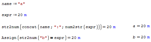

#2 Posted: 7/7/2023 5:06:15 AM
That's one of the other options.

#4 Posted: 7/7/2023 8:02:53 PM
If the value to be assigned is an ordinary expression, then just convert it to a string before using the above-mentioned methods.
asg.sm (4.31 KiB) downloaded 1383 time(s).
#5 Posted: 7/7/2023 11:52:52 PM
598 likes in 1,380 posts.
Thanks, unfortunately value to be assigned is supposed to come from somewhere else, z was just an example because I didn't want to make example with large vectors or matrices to be assigned.
Something like this?
z can be anything and come from anywhere.
As long as it has same length with v.
StrAssign.sm (6.91 KiB) downloaded 1328 time(s).
Click to enlarge
