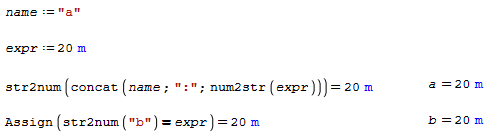

Is it possible to procedurally define variables from strings?
I want to load data to a lot of sets of variables with names following a pattern preferably without doing that manually.
Is there a better way than:
example.sm (4.39 KiB) downloaded 1346 time(s).?
#2 Posted: 7/7/2023 5:06:15 AM
1,443 likes in 2,935 posts.
That's one of the other options.

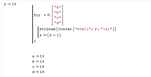

Thanks, unfortunately value to be assigned is supposed to come from somewhere else, z was just an example because I didn't want to make example with large vectors or matrices to be assigned.
I was looking for a function that would turn a string into a variable that can be used as lhs operand in assignment.

If the value to be assigned is an ordinary expression, then just convert it to a string before using the above-mentioned methods.
asg.sm (4.31 KiB) downloaded 1380 time(s).

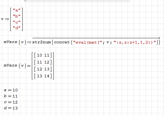

#5 Posted: 7/7/2023 11:52:52 PM
598 likes in 1,380 posts.
Something like this?
z can be anything and come from anywhere.
As long as it has same length with v.
StrAssign.sm (6.91 KiB) downloaded 1326 time(s).
Click to enlarge

#7 Posted: 7/10/2023 9:53:28 AM
Thanks, unfortunately value to be assigned is supposed to come from somewhere else ...
I was looking for a function that would turn a string into a variable that can be used as operand in assignment.
algo(col) will deal with mixed import matrix.
You can code to convert mixed or numeric or string.
Select the desired matrix-col.
Subsequently, set your maths.
The attached document SS 6179, I checked it opens 30405.
Please, confirm it opens on your system.
Cheers ... Jean.
Maths Convert-str2num COL algo.sm (5.74 KiB) downloaded 1373 time(s).
