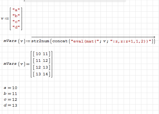

Is it possible to procedurally define variables from strings?
I want to load data to a lot of sets of variables with names following a pattern preferably without doing that manually.
Is there a better way than:
example.sm (4 КиБ) скачан 73 раз(а).?

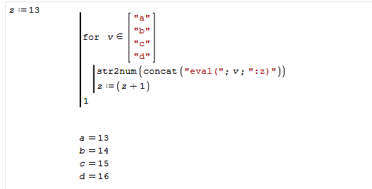

That's one of the other options.

Thanks, unfortunately value to be assigned is supposed to come from somewhere else, z was just an example because I didn't want to make example with large vectors or matrices to be assigned.
I was looking for a function that would turn a string into a variable that can be used as lhs operand in assignment.

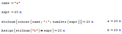

If the value to be assigned is an ordinary expression, then just convert it to a string before using the above-mentioned methods.
asg.sm (4 КиБ) скачан 74 раз(а).
Something like this?
z can be anything and come from anywhere.
As long as it has same length with v.
StrAssign.sm (6 КиБ) скачан 66 раз(а).
Click to enlarge
