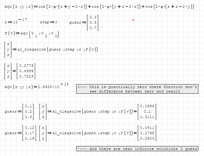

al_nleqsolve equ(x,y,z).sm (10 KiB) downloaded 58 time(s).
But your equation seems to have infinite solutions.

As overlord points, there are infinite solutions. Just like the better visual representation for z = f(x,y) is a surface in the 3D space, w = f(x,y,z) is a hypersurface in the 4D space. But we can't see that plot. So, here a plot of families of that 4D hypersurface, like a contour plot, but with surfaces.

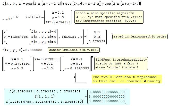

Well, Fridel it's an expert too, thanks.
Joining above Dragilev and 4D methods.
Plots4D_DM3.sm (111 KiB) downloaded 71 time(s).
Plots4D_DM3.pdf (182 KiB) downloaded 70 time(s).
