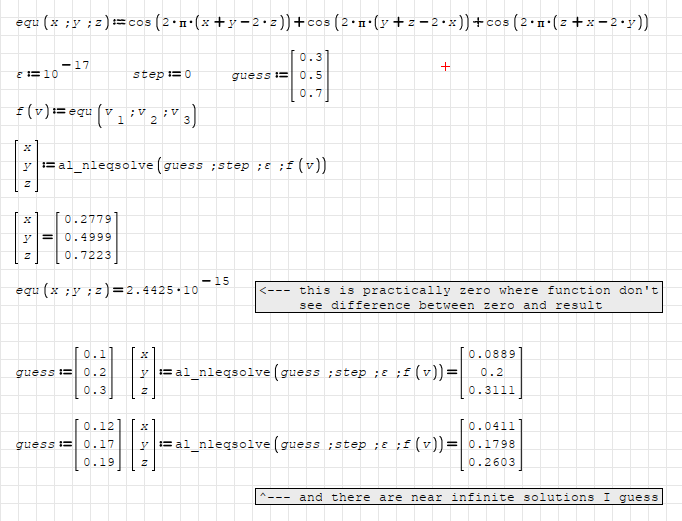

#2 Опубликовано: 05.07.2021 10:41:14
More experienced users may help you better than me.
But your equation seems to have infinite solutions.
al_nleqsolve equ(x,y,z).sm (10 КиБ) скачан 58 раз(а).

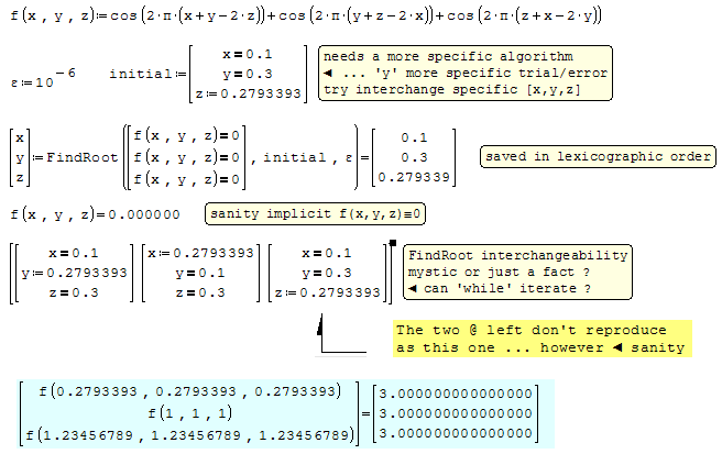

Oscar Campo 05.07.2021 21:01:00
#4 Опубликовано: 05.07.2021 21:15:59
#5 Опубликовано: 06.07.2021 01:46:40
Alvaro Diaz Falconi 06.07.2021 03:06:00
