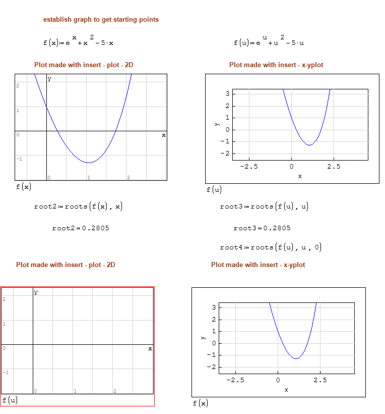

Hello Joe,
That is because you have to put "x" as a formal argument in the insert 2D plot (it is always "x" to f(x)). For insert 2D plot it does not matter if "x" is previously defined or not. XY plot works differently. It needs an undefined argument (f(x) and f(u) are the same as long as both "x" and "u" are undefined).

WroteI am not sure why SMath does not like insert - plot - 2D for f(u)
For the "QuickPlot" the plotting canvas argument is 'x' only 'x'.

Another question - I am reading through all the handbooks and as I read I keep adding the examples into a SMath page so as a result I will define and redefine variables ('x') and functions ( f(x) ) many times as I work through the example problems. I have run into a issue where it appears SMath gets confused if I redefine 'x' or f(x) too many times. I get error messages but if I copy and paste the particular section onto a new page by itself everything works. Again is there something I am doing wrong?

Hello Joe,
In your example roots(f(x),x)= will not work because you have x defined previously. Function roots() needs undefined variables. There is no consensus here about undefined variables in the cases similar like this one. You might use some variables that have low chances to be defined in your worksheet (something like roots(f(#x),#x)= or roots(f(_x),_x)= etc.)
