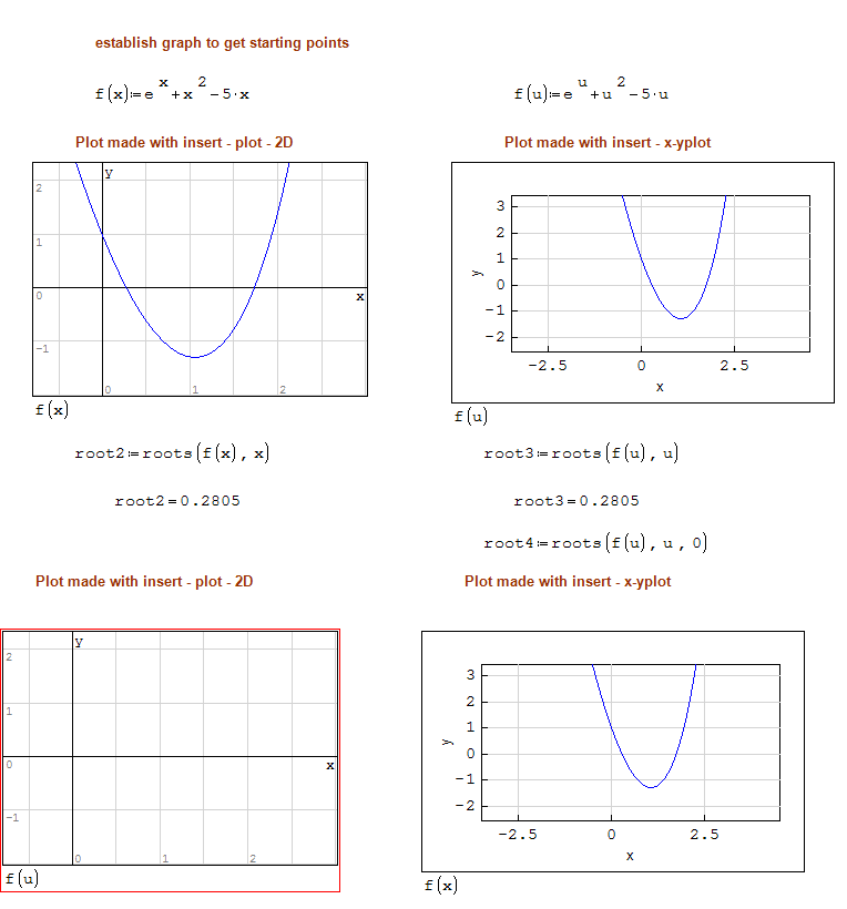

I am not sure why SMath does not like insert - plot - 2D for f(u)
Thanks
Joe
#2 Опубликовано: 02.04.2017 03:51:35
Hello Joe,
That is because you have to put "x" as a formal argument in the insert 2D plot (it is always "x" to f(x)). For insert 2D plot it does not matter if "x" is previously defined or not. XY plot works differently. It needs an undefined argument (f(x) and f(u) are the same as long as both "x" and "u" are undefined).
#3 Опубликовано: 02.04.2017 08:32:18
For the "QuickPlot" the plotting canvas argument is 'x' only 'x'.
