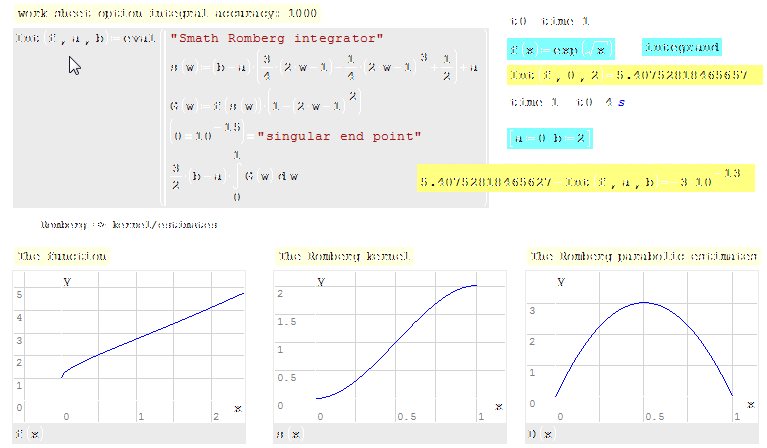

How come this screen shot was crap ?
Test a new one.

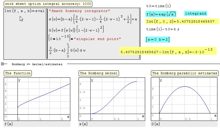

#30 Posted: 5/25/2017 10:17:44 AM
Try again ...
#31 Posted: 5/25/2017 10:25:12 AM
I'm replying to myself:
No matter the size of the screen shot, XP Home were all correct in the Forum.
Since I'm on Win 7 Laptop, above an unknown size, screen shot are crappy !
