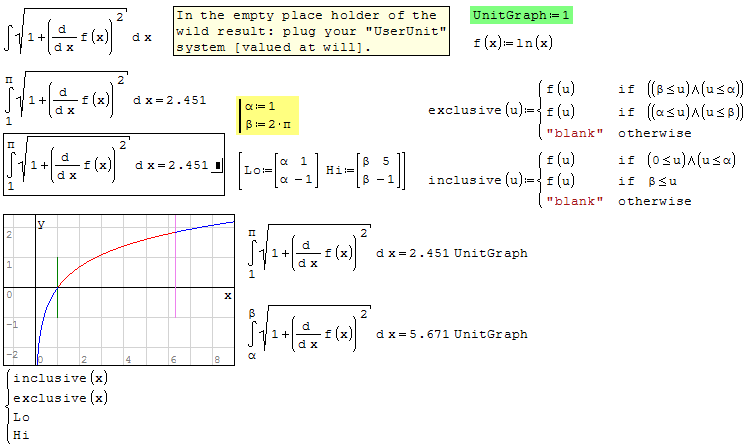

Hello David,
Many Smath users are "pro" using the unit system, not me because unit system
does not pass QA [Quality Assurance]. From a wild result [not unit affected],
you can post-add your own system.
UserUnit.sm (13.41 KiB) downloaded 1118 time(s).

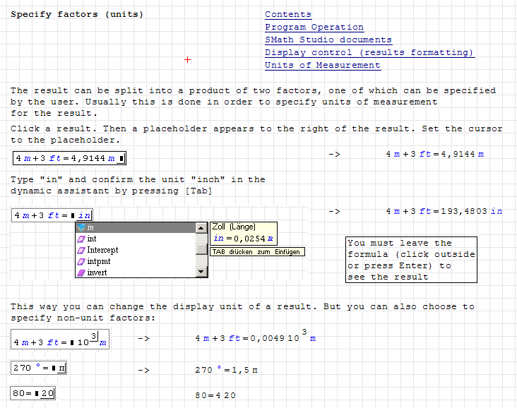

#5 Posted: 5/21/2017 4:33:42 PM
I cannot create this system of units by changing the constant.xml and units.xml sheets because the underlying structure is different. I have also created worksheets with unit definitions that work, but the software wants to produce the results in SI units, which is really messy. I need to have the results in the native units I have devised.
Maybe, it is as easy as typing the unit you want for the result in the square black placeholder?
2017-05-21 21_30_24-SMath Studio 0.98.6179 - [Section operation units.sm].png
Section operation units.sm (21.32 KiB) downloaded 1100 time(s).
#6 Posted: 5/21/2017 4:55:47 PM
David Thomson
David Thomson
1 likes in 31 posts.

#16 Posted: 5/22/2017 3:53:42 PM
Thanks Dave for explaining.
In the mean time you design the "Special Unit System",
you can publish your work for demo as attached.
Use the writer region close to the result.
Mathcad 11 was able to do it nice because the text region
accepted result as well as formulae.
Big Electron.sm (4.94 KiB) downloaded 1100 time(s).
