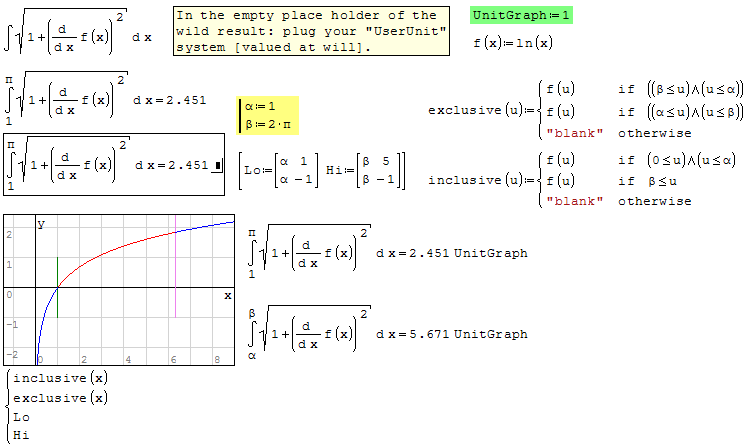

Many Smath users are "pro" using the unit system, not me because unit system
does not pass QA [Quality Assurance]. From a wild result [not unit affected],
you can post-add your own system.
UserUnit.sm (13,41 КиБ) скачан 1118 раз(а).

Here is the work sheet in compacted image.
Hope it open, no crash ?

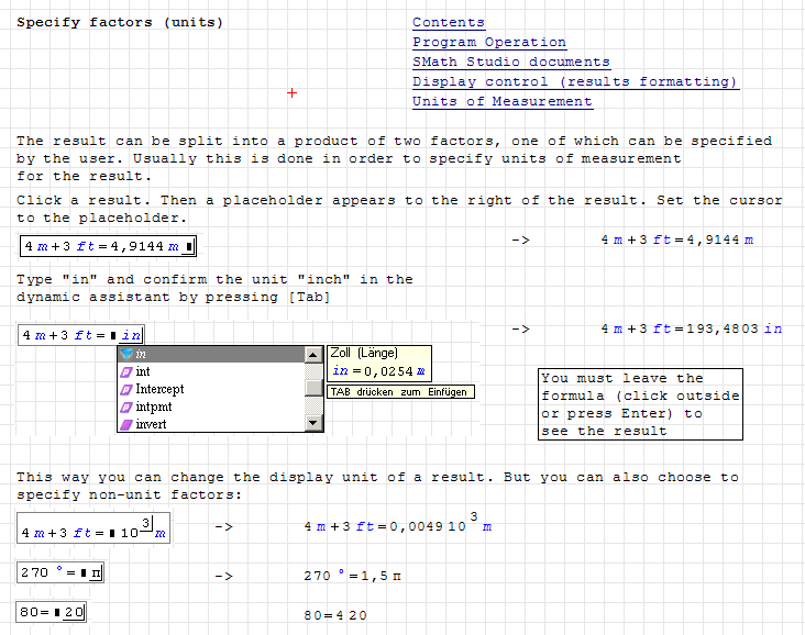

Maybe, it is as easy as typing the unit you want for the result in the square black placeholder?
2017-05-21 21_30_24-SMath Studio 0.98.6179 - [Section operation units.sm].png
Section operation units.sm (21,32 КиБ) скачан 1100 раз(а).

That's what I suggested "paste in the rightmost place holder"
paste the unit as written in "Writer region" ...+++ more symbols.
