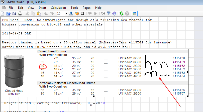

I created (in Windows 7, SMath Studio version 0.95.4594) a worksheet for a set of calculations I was working on. I embedded an image in the sheet (Copy->Paste) (see attached).

When I open theattached file, at the console an error is reported:
libpng error: invalid bit length repeat
and the image does not load (the rest of the file loads OK, from what I can tell).

It seems that the problem of freehand drawing on picture region still remained in Linux. I've seen this long time ago on some older SMath versions and I thought it was fixed.
Hmm... it seems it is still present in this SMath file in Windows as well
I do not remember when is this happening ? If we use "Insert|Picture|Create" we get a blank region a and there we can draw with a mouse. I remember (and I checked it out) that when we use "Insert|Picture|From file" or we insert a picture from clipboard that there is no possibility to freehand draw inside picture region.
Now I am puzzled and can not understand how Duane inserted that picture...
Duane, can you please tell us how did you insert that picture inside the SMath document?

Thanks for taking time to look into this. I would really like to be able to freely share documents between Windows and Linux.
So, I created the embedded picture by using the Windows 7 Snipping Tool (snipping from a Web browser window), and circling in red the size I wanted to indicate in the picture (I circled it with the pencil the Snipping Tool provides).
I then Ctrl-V (pasted the clipboard) into the SMath sheet

I would also like that SMath documents can be freely shared between Windows and Linux. But it seems that this is not that easy at the moment. When would that happen - I do not know. That just depends on SMath author, Andrey Ivashov. I think there is no other way for the moment, just to wait and hope.
On the other hand, I was a bit out of topic and I am sorry for that. I just forgot the "Edit" option regarding pictures which just disables the behavior of freehand mouse drawing on the picture region (a strange option present in previous SMath versions). I do not believe (can not be sure, of course) this has any connection regarding pictures and Windows<->Linux SMath files.
