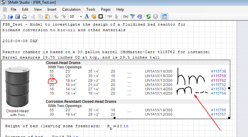

I recently discovered SMath Studio, and am learning how to use it. So far, I am impressed. I did run into a little problem though.
I created (in Windows 7, SMath Studio version 0.95.4594) a worksheet for a set of calculations I was working on. I embedded an image in the sheet (Copy->Paste) (see attached).
I E-mailed the file to myself to look at at home with my Linux (Debian Squeeze, SMath Studio version 0.95.4594) machine. Info from the Linux box:
Mono JIT compiler version 2.6.7 (Debian 2.6.7-5.1) Copyright (C) 2002-2010 Novell, Inc and Contributors. www.mono-project.com
TLS: __thread
GC: Included Boehm (with typed GC and Parallel Mark)
SIGSEGV: altstack
Notifications: epoll
Architecture: x86
Disabled: none
When I open theattached file, at the console an error is reported:
libpng error: invalid bit length repeat
and the image does not load (the rest of the file loads OK, from what I can tell).
Please let me know if I can provide any more information.
Thanks,
Duane
FBR_Test.sm (49 КиБ) скачан 78 раз(а).

It seems that the problem of freehand drawing on picture region still remained in Linux. I've seen this long time ago on some older SMath versions and I thought it was fixed.
Hmm... it seems it is still present in this SMath file in Windows as well
I do not remember when is this happening ? If we use "Insert|Picture|Create" we get a blank region a and there we can draw with a mouse. I remember (and I checked it out) that when we use "Insert|Picture|From file" or we insert a picture from clipboard that there is no possibility to freehand draw inside picture region.
Now I am puzzled and can not understand how Duane inserted that picture...
Duane, can you please tell us how did you insert that picture inside the SMath document?

Omorr, I did the following as Duane stated:
I sent one of these images to the clipboard and copied it to Smath with ctrl+v, then mouse drawing is allowed by making right-click over the image and selecting 'edit'.

I sent one of this images to the clipboard and copied it to Smath with ctrl+v, then mouse drawing is allowed by making right-click over the image and selecting .
Yes you are right. I forgot the right-click on the picture and "Edit" option from the context menu, sorry .
This option just suppress unintentional drawing over the pictures. I do not know any other purpose of this option.
However, I think the problem with pictures in Linux remained unresolved.

Thanks for taking time to look into this. I would really like to be able to freely share documents between Windows and Linux.
So, I created the embedded picture by using the Windows 7 Snipping Tool (snipping from a Web browser window), and circling in red the size I wanted to indicate in the picture (I circled it with the pencil the Snipping Tool provides).
I then Ctrl-V (pasted the clipboard) into the SMath sheet
Again, please let me know if you need any more information, or want me to run other tests.
Duane

I would also like that SMath documents can be freely shared between Windows and Linux. But it seems that this is not that easy at the moment. When would that happen - I do not know. That just depends on SMath author, Andrey Ivashov. I think there is no other way for the moment, just to wait and hope.
On the other hand, I was a bit out of topic and I am sorry for that. I just forgot the "Edit" option regarding pictures which just disables the behavior of freehand mouse drawing on the picture region (a strange option present in previous SMath versions). I do not believe (can not be sure, of course) this has any connection regarding pictures and Windows<->Linux SMath files.
