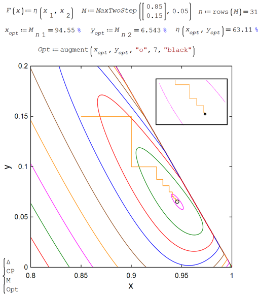

Do you know more correct method?
8-28-33-St-Isp.sm (63 КиБ) скачан 97 раз(а).

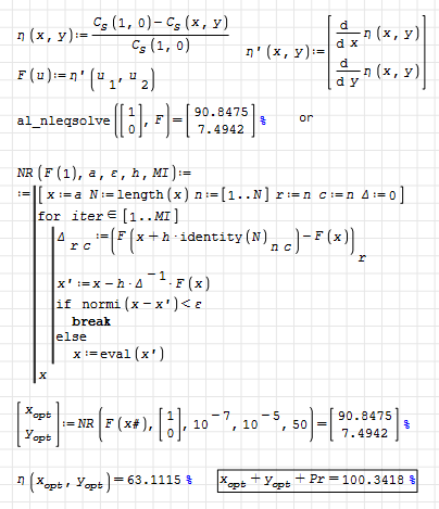

This one?
