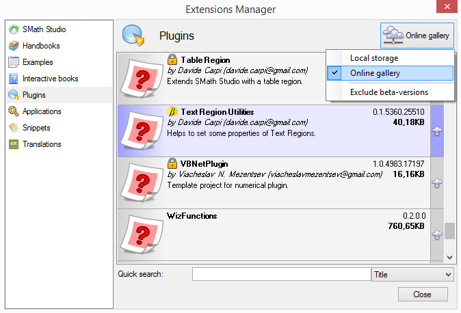

#4 Опубликовано: 06.09.2014 13:33:42
Ernesto, Extensions Manager allows to update plug-ins.
Please see attached image. Select Online gallery and see the list - available updates shown in violet.
