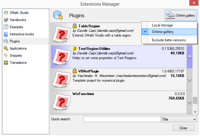

Ernesto, looks like you have some outdated plug-ins. Please open Extensions Manager update installed plug-ins.

The Extensions Manager only gives the option to enable or disable the plugins. I don't see how I could delete or update any of the plugins.
I even tried uninstalling and installing Smath Studio again, and the same error appears.
