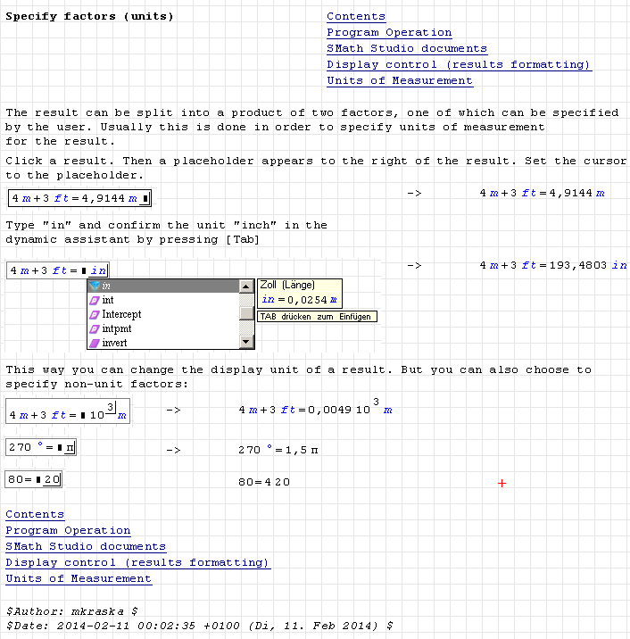

You can do that right now.
The attached help page is found in the interactive handbook under
Toolbar [?]> Units of Measurement> Units in Results Display

That's just setting the units manually, though. It should be possible to specify the unit as "m", and it automatically displays "10 nm" or "10 km" when the number changes, without manually typing in "km".
