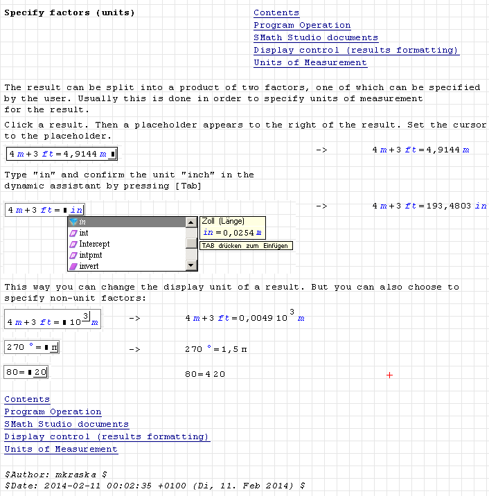

You can do that right now.
The attached help page is found in the interactive handbook under
Toolbar [?]> Units of Measurement> Units in Results Display
Radovan Omorjan 03.03.2014 10:13:00
