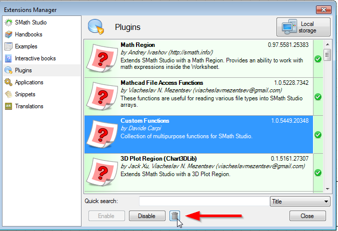

Seems you have some outdated plugins.
Go to Tools > Plugins and try to uninstall every custom plugin.
If this option is not available in your SMath Studio:
![2015-07-28 15_35_40-SMath Studio Desktop - [API RP2A-WSD - SMath id.sm].png](/ru-RU/files/Download/LbqkAw/2015-07-28-15_35_40-SMath-Studio-Desktop---[API-RP2A-WSD---SMath-id.sm].png)
- Close your SMath Studio
- copy & paste %APPDATA%\SMath\extensions\plugins in the search field of your start menu and press enter
- delete eveything in that folder
- open SMath and download again the plugins you need

I did the same you say, delete all documents in the folder and the problem was solved.
