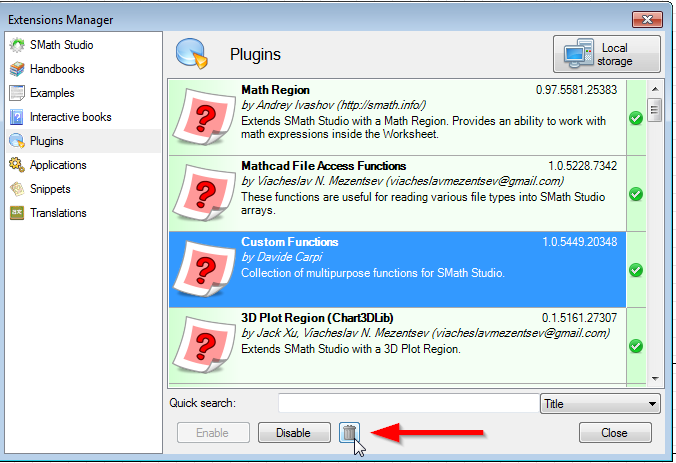

Hello people, i need your help because i dont know why after download some plugins (i cant remember which one) the functions doesnt work more... I tried to change most of options and cant repair it.
Im new at this, so i would be very happy if u can help me.

Seems you have some outdated plugins.
Go to Tools > Plugins and try to uninstall every custom plugin.
If this option is not available in your SMath Studio:
![2015-07-28 15_35_40-SMath Studio Desktop - [API RP2A-WSD - SMath id.sm].png](/ru-RU/file/LbqkAw/2015-07-28-15_35_40-SMath-Studio-Desktop---_API-RP2A-WSD---SMath-id_sm__png)
- Close your SMath Studio
- copy & paste %APPDATA%\SMath\extensions\plugins in the search field of your start menu and press enter
- delete eveything in that folder
- open SMath and download again the plugins you need

Sorry, but I tried to find the solution yesterday and today, when I found the answer you've already answered ...
This is the post:
http://en.smath.info/forum/yaf_postst2752_IF-function-error.aspx#post14902
I did the same you say, delete all documents in the folder and the problem was solved.
Again you save me Davide, you people, are awesome!
