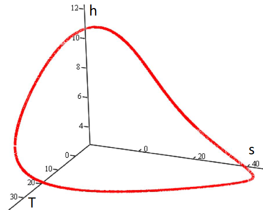

How can I plot 3-D diagram? So for example.
See please the SMath attach!
GTU-Ro-T.sm (383 КиБ) скачан 66 раз(а).
#2 Опубликовано: 05.05.2023 08:32:19
WroteHow can I plot 3-D diagram? So for example.
1. Arrays dimension do not match.
2. Once doctored, maybe Maxima.

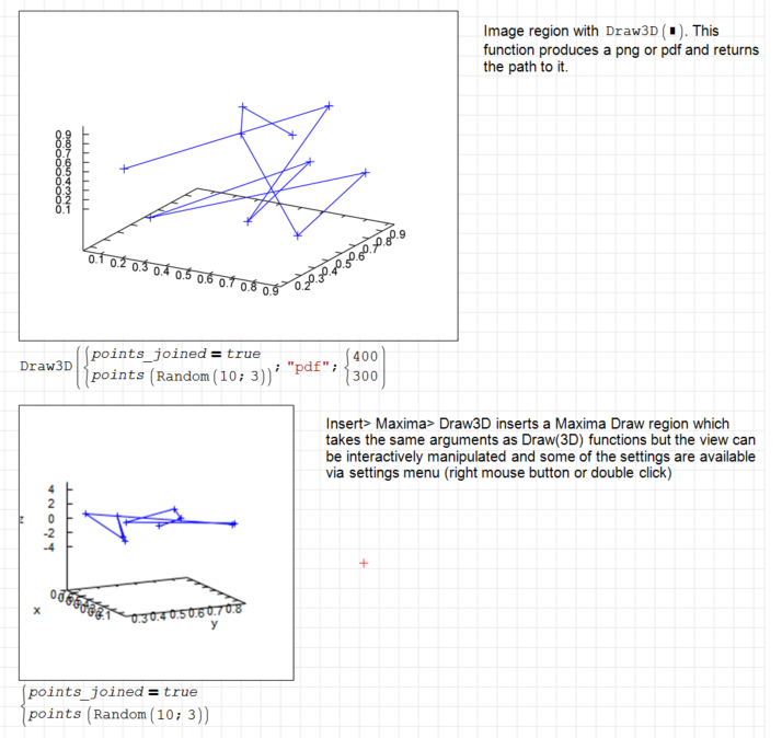

If the Maxima Plugin is an option for you, then just create a n x 3 data matrix and plot it using Draw3D. You find more plot examples in my Handbuch (section 8.1).
![2023-05-05 17_05_28-SMath Solver - [GTU-Ro-T.sm_].png](/ru-RU/file/nWAraA/2023-05-05-17_05_28-SMath-Solver---_GTU-Ro-T_sm___png)
GTU-Ro-T_Kr.sm (395 КиБ) скачан 68 раз(а).

In response to this Thread...I have a question.. I modified points-joined=false and it works, but how can I get Points instead of little crosses?
