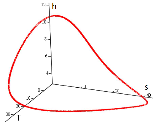

How can I plot 3-D diagram? So for example.
See please the SMath attach!
GTU-Ro-T.sm (383,51 КиБ) скачан 1396 раз(а).
WroteHow can I plot 3-D diagram? So for example.
1. Arrays dimension do not match.
2. Once doctored, maybe Maxima.

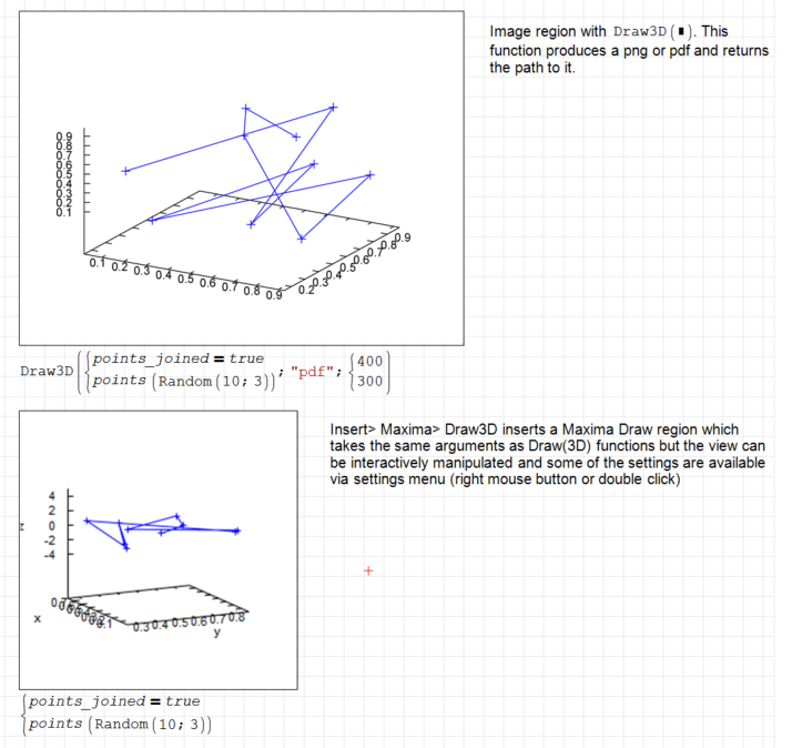

If the Maxima Plugin is an option for you, then just create a n x 3 data matrix and plot it using Draw3D. You find more plot examples in my Handbuch (section 8.1).
![2023-05-05 17_05_28-SMath Solver - [GTU-Ro-T.sm_].png](/ru-RU/files/Download/nWAraA/2023-05-05-17_05_28-SMath-Solver---[GTU-Ro-T.sm_].png)
