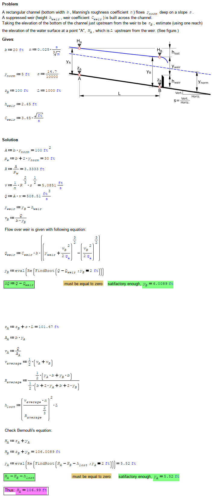

I'm trying to make a SMath worksheet for calculating flow over weir. The problem is iterative, i.e. when you calculate it "by hand" you have to estimate some values and then check if your estimation is close enough.
Here is my workbook:
suppressed_weir.sm (79 КиБ) скачан 68 раз(а).
suppressed_weir.pdf (365 КиБ) скачан 80 раз(а).
I tried to solve this problem by using "solve (2)" function, but I'm obviously doing something wrong...
Could anyone help me with this?
Cheers,
Sandro

#3 Опубликовано: 22.06.2021 13:52:40
Cheers,
Sandro
Hope this is enough for you.
Solve can't work with units.
Sometimes it just refuses even without units.
Use roots(), FindRoot(), al_nleqsolve() if it fails.
In this order generally.
Regards.
suppressed_weir1.sm (82 КиБ) скачан 68 раз(а).

Thank you, overlord, that works exactly as I wanted!
