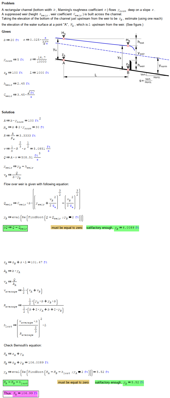

I'm trying to make a SMath worksheet for calculating flow over weir. The problem is iterative, i.e. when you calculate it "by hand" you have to estimate some values and then check if your estimation is close enough.
Here is my workbook:
suppressed_weir.sm (79,98 КиБ) скачан 1138 раз(а).
suppressed_weir.pdf (365,79 КиБ) скачан 747 раз(а).
I tried to solve this problem by using "solve (2)" function, but I'm obviously doing something wrong...
Could anyone help me with this?
Cheers,
Sandro

#3 Опубликовано: 22.06.2021 13:52:40
Cheers,
Sandro
Hope this is enough for you.
Solve can't work with units.
Sometimes it just refuses even without units.
Use roots(), FindRoot(), al_nleqsolve() if it fails.
In this order generally.
Regards.
suppressed_weir1.sm (82,41 КиБ) скачан 1137 раз(а).
#4 Опубликовано: 22.06.2021 14:25:22
sandros
sandros
Use roots, FindRoot, al_nleqsolve if it fails.
Regards.
Thank you, overlord, that works exactly as I wanted!

#6 Опубликовано: 23.06.2021 05:12:27
I am glad to help you exactly as you wanted.
