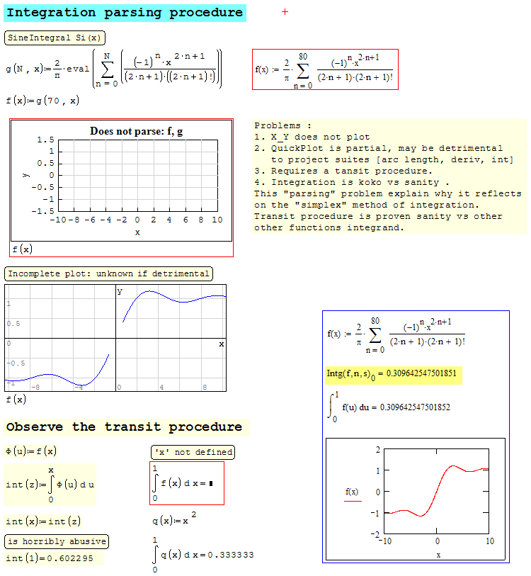

#1 Опубликовано: 10.06.2016 12:02:11
That one is for Designers wrt the latest Nightly build.
Done in Smath 5346 OFFicial release.
jean
Maths Integration Parsing Procedure.sm (23 КиБ) скачан 75 раз(а).

#2 Опубликовано: 11.06.2016 09:33:19
Jean,
Thank you! Fixed. And... if previous versions of SMath Studio required eval() function to be used, now it doesn't matter anymore.
eval_sum_plot_bug.sm (7 КиБ) скачан 69 раз(а).
