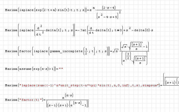

#3 Опубликовано: 10.10.2013 15:17:39
You might try the Maxima plugin. Maxima is free and open source. I tried to reproduce some of the handbook examples.
Radovan Omorjan 11.10.2013 01:14:00
